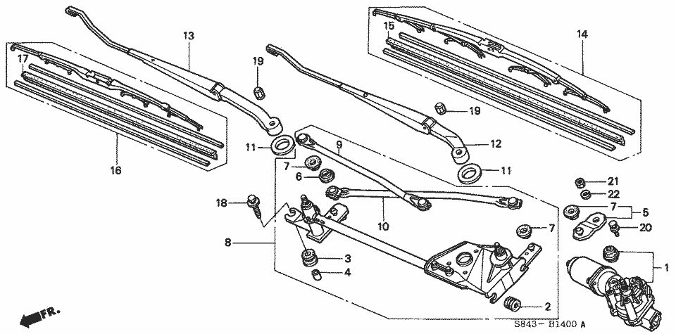

Usually that's from a real loose bushing in the linkage underneath the cowl. To confirm, lift the wiper off the glass and it should have quite a lot of loose motion. Not sure how easy it is to get a look, but maybe a bushing on the end of the bars #9 & #10 in the picture?
Attached Thumbnails New member with a annoying wiper issue-2000-windshield-wipers.gif

Yeah, I bought an entire "wiper transmission" for my 99, and it fixed what I had (a blown out cup assembly). I got mine thru Rock Auto.
