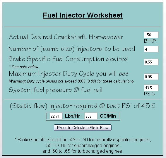

I have a V-AFC2 for sale. You could tune your car with it. It'll waste the dyno-tuning that is on it for the V6, but it works flawlessly and you won't find a cheaper engine management computer anywhere ..... PM me for details.
BTW, those injectors are killing you ..... look:
