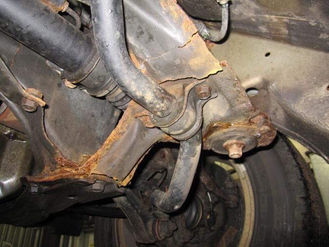

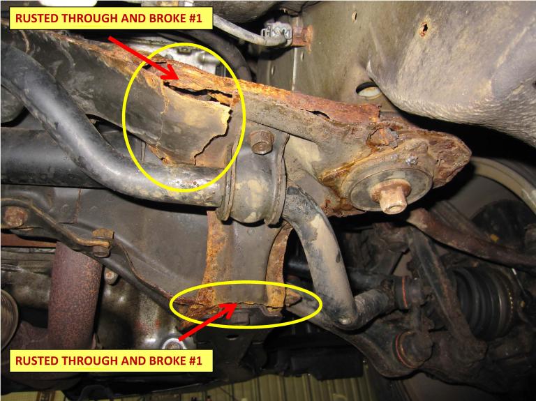

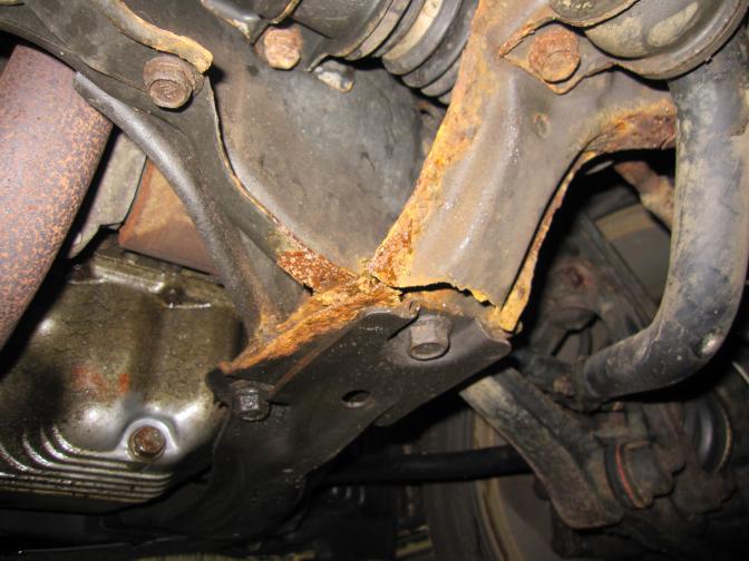

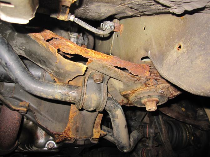

I have a 1998 Accord EX v6 3.0L.I changed the oil over the weekend and notice a suspension component that was so badly corroded that it actually broke in separate pieces in 2 different places.I could move the pieces slightly with just my fingers.See photos.
I don’t know what this part is called or its exact function but I want to know if it’s safe to continue driving the car?It must have something to do with the suspension/steering system but I never noticed anything driving the car.It drives and steers fine.If I wouldn’t have noticed it changing the oil I wouldn’t have known the difference.It actually could have been like this for a while.The same arm on the driver’s side is in much better shape than this one.
It’s so badly corroded I don’t know if it’s even replaceable.But what I first want to know is if it’s safe to continue driving the car or if I’m risking losing the wheel or something else very unsafe?

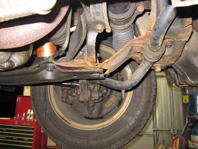

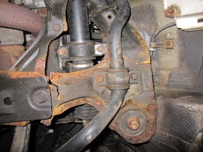

Here's a couple more photos...

Piece is the front beam and supports steering and engine. Do not drive IMO!
It can be replaced but engine will need support to perform replacement.
