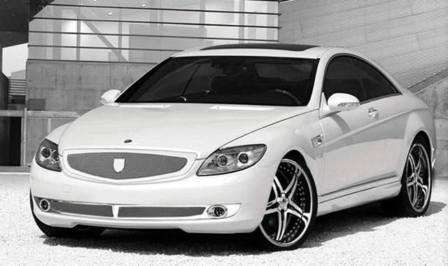

Talking * If Your Interested *
If your interested in something smaller...say 20" then here are some dimensions
for you to look at.
Plus 20 specs are ...Tires: 225/30/20, Wheel hub: 64.1mm , Off Set:35-42mm
Your overall OutSide Diameter for stock wheel and tire is 24.7"
Your overall Outside Diameter for the 20" will be 25.3" so you see there is hardly any problem on the overall diameter which would change your speedometer , ABS , or computer controlled operations.
Attached Thumbnails Will 22" rims fit on a Accord LX Coupe?-imagesymbolicwheels09.jpg
