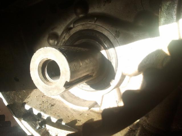

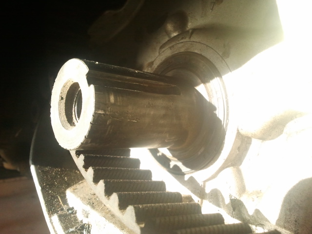

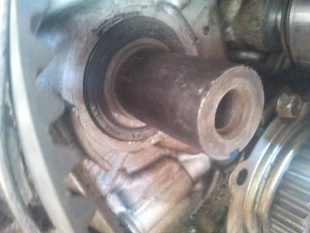

Hey gotta question... well my crankshaft still work. Or is it shot? Went to the salvage yard today, and all the crankshafts looked like this. But these pics are of MY crankshaft. Do i replace my crankshaft??? What should it look like? Help plez

Suggest taking a file to knock off the rough upsets and polishing w/ emery cloth tape till very smooth. Keyway looks fine. Problem would arise if you ever install new crankshaft seal. New seal would be damaged going over rough crankshaft end.
Looks like someone used a pipe wrench to turn the engine w/o a timing belt. Valves will be damaged. Cylinder head work necessary.

you might have a tough time getting the timing crank gear and harmonic balancer pulley on the crank with that type of damage.
