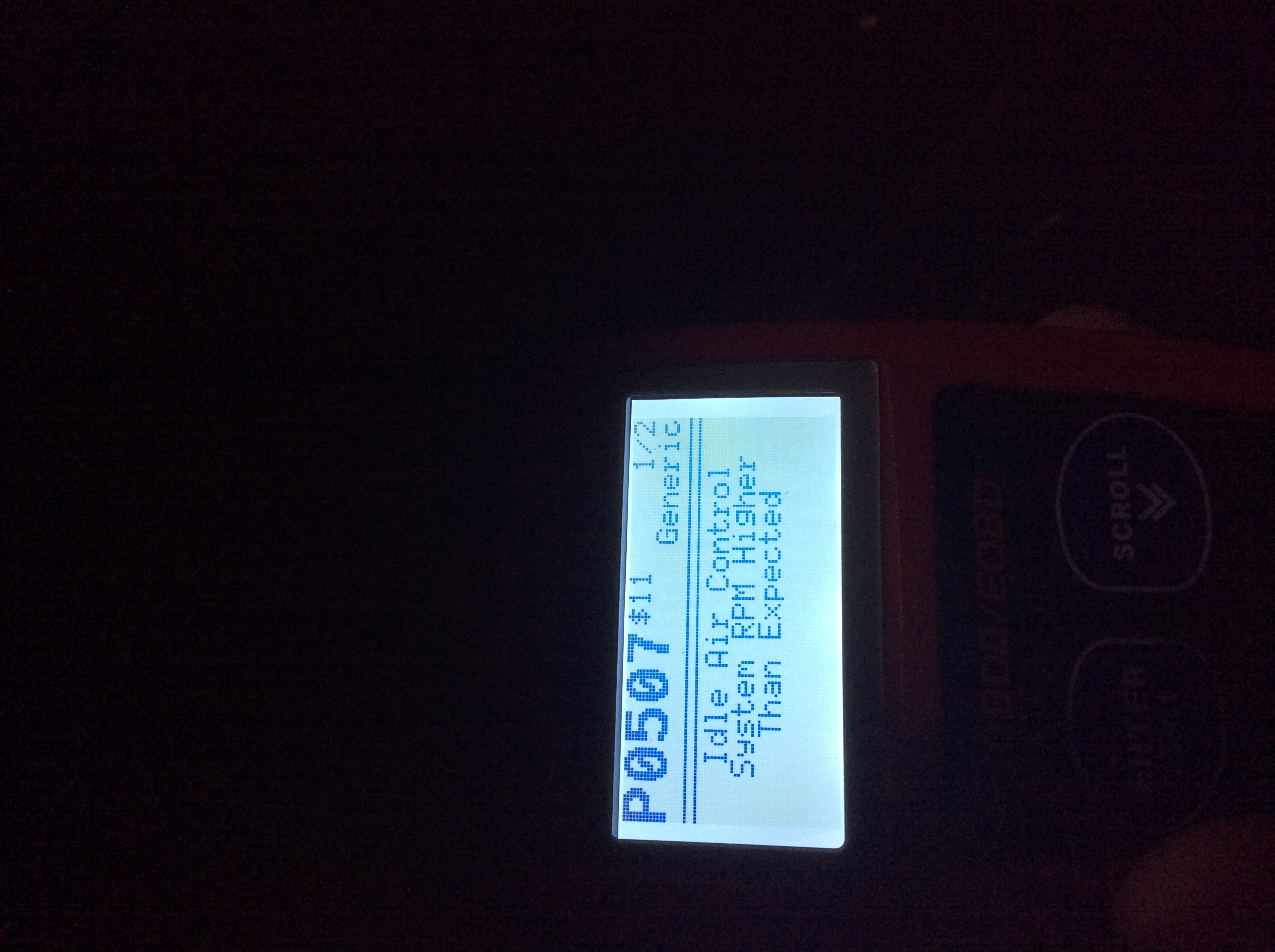

Thank you for the response PAHonda. P0507 is the same code over and over. I have the cheap scanner from Wal Mart. $20 bucks. I think it will freeze frame. I will get a picture of readings and post them.

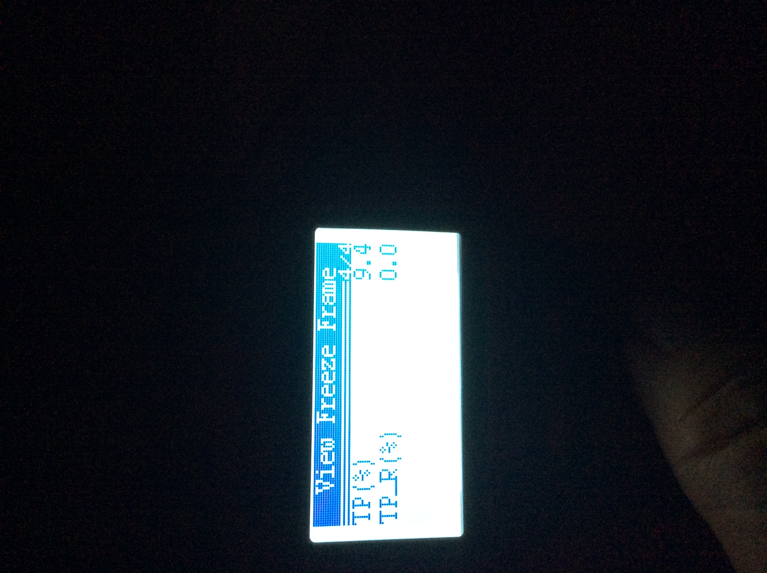

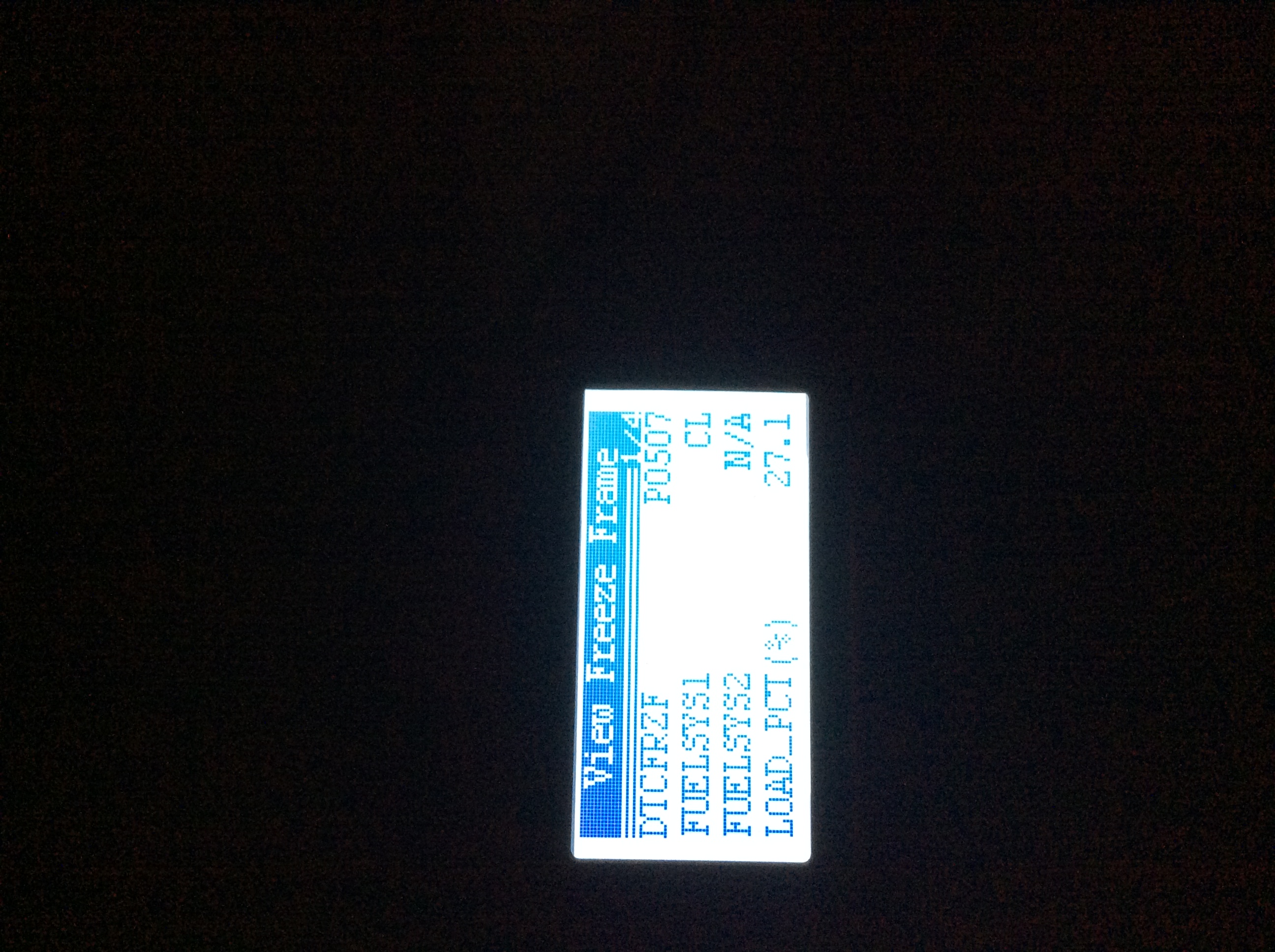

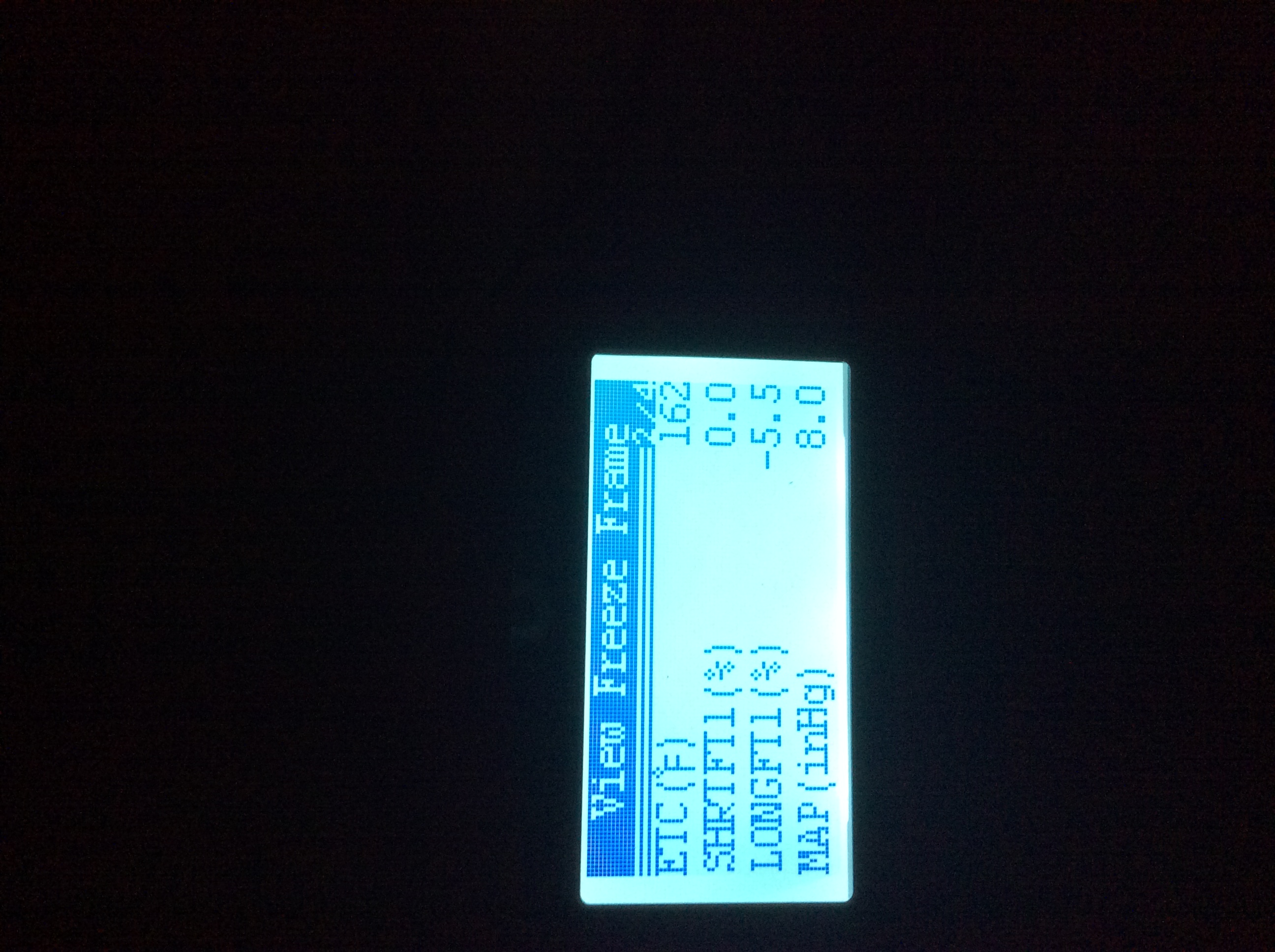

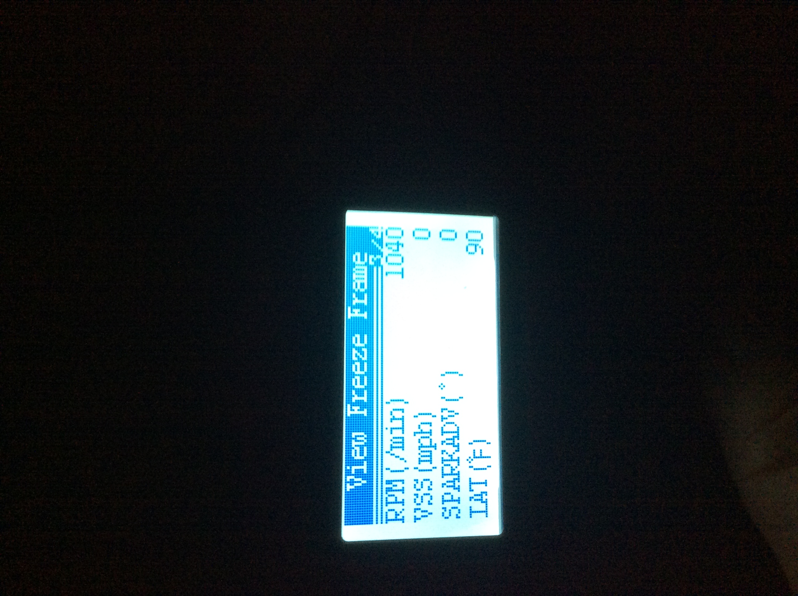

Here are pics of code reader freeze frame.
Attached Thumbnails 03 Ex 5mt surging after replacing air duct hose clamp-img_8411.jpg   03 Ex 5mt surging after replacing air duct hose clamp-img_8412.jpg   03 Ex 5mt surging after replacing air duct hose clamp-img_8413.jpg   03 Ex 5mt surging after replacing air duct hose clamp-img_8414.jpg   03 Ex 5mt surging after replacing air duct hose clamp-img_8415.jpg
