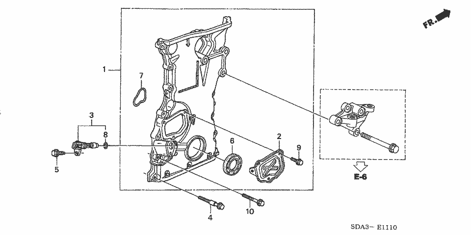

Unless you remove the crankshaft pulley, you may not be able to see a couple things.
#3 is a crankshaft timing sensor.
#2 is a cover over the timing-chain tensioner.
Either of those things would be easier to fix than the front crankshaft seal #6.
