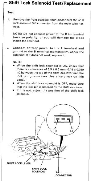

Old Nov 12, 2011 | 02:35 PM
https://www.hondaaccordforum.com/for...threads-40780/
Then see if this helps
Attached Thumbnails 1995 Honda Accord LX not coming out of park-5th-gen-interlock.jpg

Thanks, I will check tonight if the brake lights are working and see if i hear a click from the shift interlock. Does anyone know what the D4 light blinking code 10 is? It's now blinking codes 10 and 13.
