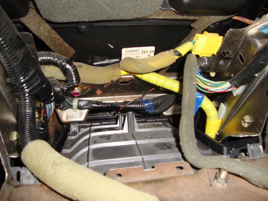

This is a picture below the radio... nothing stands out to me... thoughts?

That honda tech thread showed the connectors for your PCM. Didn't mean for you post in that forum.
I think that the PCM is as close carpet on the hump in the floor board as you can get. It is somewhere under that piece of plastic at the bottom of the picture you posted. You might not be able to access it from where the radio is installed.

I found the connections under the passenger floormat, thanks for the help!
