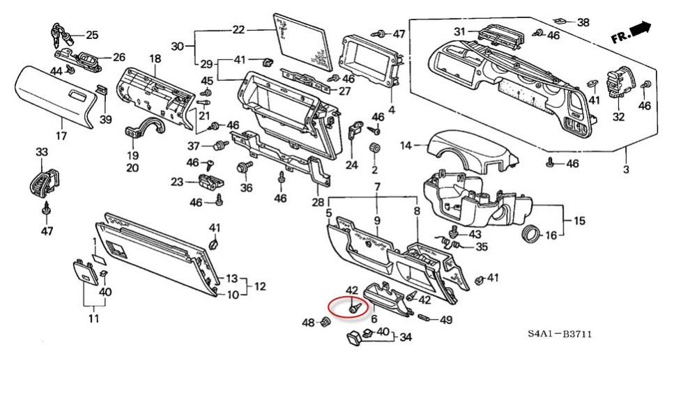

Originally Posted by Jez(UK)
Hi Guys,
Right I've poked my head underneath and of course everything looks flush !
I've had a look at the coin box and the 2 screws that I can see need a special screwdriver to undo them (kinda like an allen key, but not !) - they aren't flat-headed or cross-headed screws like I was expecting.
So, once I undo those (that is if I know where I'd be able to purchase such a tool), the trim just pulls off ??
Please can someone confirm ??
Many thanks,
Jez
It looks like the UK Accord uses what is called a cassette box stopper, UK Honda part number PFKL1014423 (U.S. Honda part number 91637-SD4-000). They may be Torx screws. If they are Torx screws, then you need a Torx driver. In the U.S, it is easy to get Torx drivers; I'm not sure about U.K.
Once the screws (er, cassette box stoppers; lol), it should only be held in with clips and/or hooks. Just do it slowly, if the plastic panel has hooks, that area of the panel needs to be lifted.
