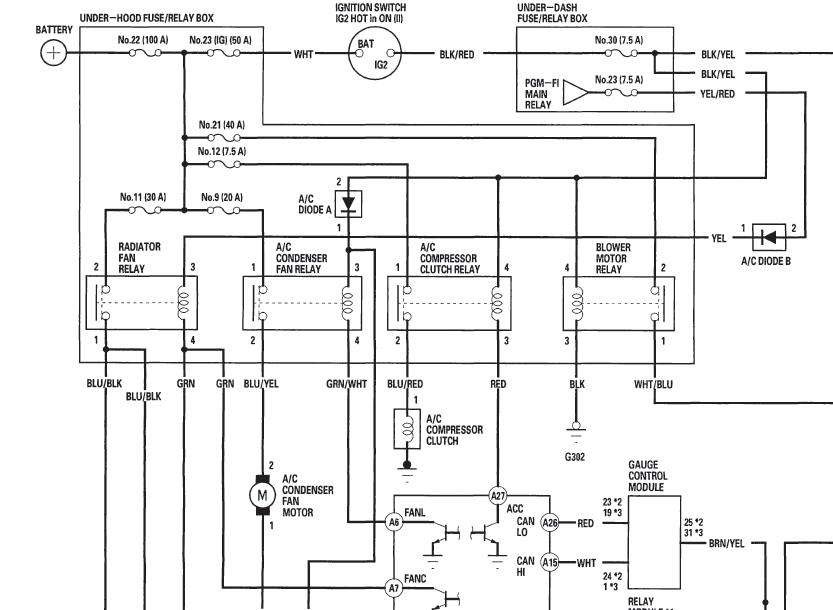

Hang on, I'm not willing to give up yet. If you are willing to do a few more things?
I'm attaching a pic. Two inputs to the relay, key on, should be hot. When the ac is turned on, another will ground, closing the relay and sending power. Test the inputs, test the relay.

I will check for the voltages and ground at pin 3 later today.

Clutch relay voltages are good at pins 1 and 4. Still no ground on Pin 3 from the ECM. Both radiator fans and the inside fan come on with A/C on.
A/C works fine if apply 12v to Pin 2; Compressor clutch then enagages.
At this point, any guidance on ECM replacement would be much appreciated.
