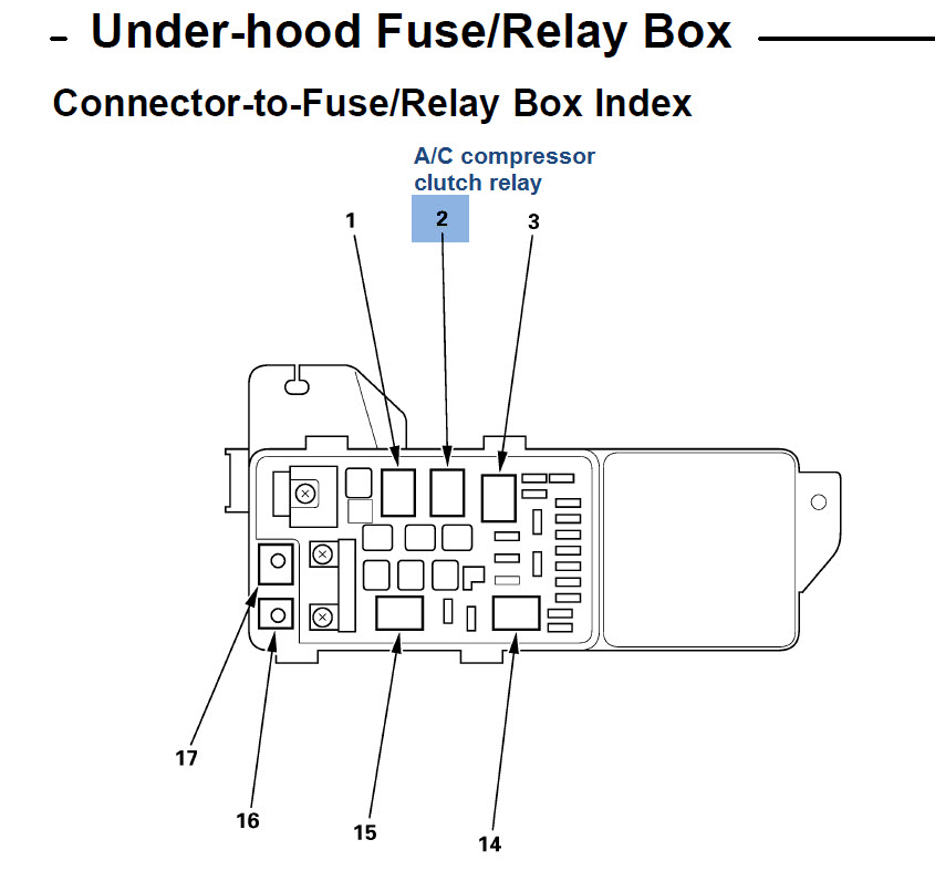

2. Check under-hood Fuse No. 12 (7.5A) to make sure the fuse for the A/C compressor clutch relay is not blown.
3. If under-hood Fuse No. 12 is okay, to do a brief test to check that the compressor runs:
a. The A/C compressor clutch relay is number 2, as shown in the attached under-hood fuse/relay box diagram.

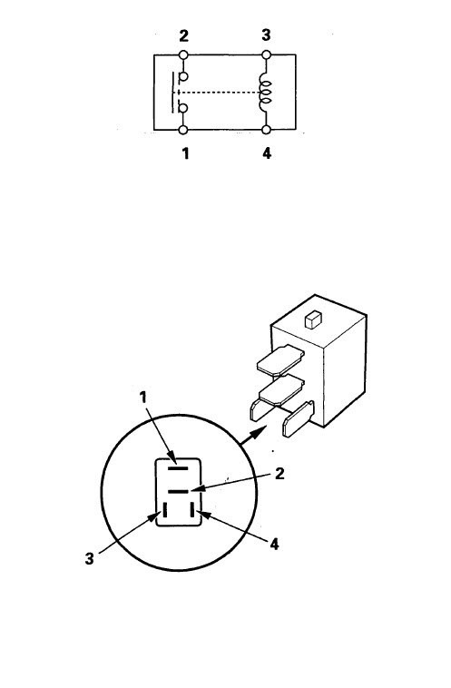

b. You would pull that relay out, then use a jumper wire where relay terminals no. 1 and no. 2 would normally be plugged into.
https://www.hondaaccordforum.com/for...king-relay-jpg
Does the compressor run? Only do the test briefly. Do not leave it this way.
