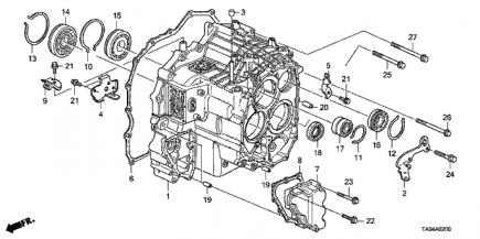

Recently checked the transmission fluid on my 2008 V4 Sedan, and I noticed an open tube right next to the transmission dipstick.
It looks like a tube for a dipstick, but there's no dipstick in it, and I don't like seeing open tubes extending down into my transmission.
What is that, and should it be open?
Old Dec 15, 2013 | 05:13 PM
That's the vent tube. You're probably missing the breather cap if it is uncovered. Part # 3 in diagram.
Btw: Your 4 cylinder is an I4 engine.
Attached Thumbnails 2008 Sedan V4 - tube near transmission dipstick?-transmission-case-l4-469450.jpg
Old Dec 15, 2013 | 05:27 PM
It Honda part # 21396-PX5-000.
Here's a picture.
Attached Thumbnails 2008 Sedan V4 - tube near transmission dipstick?-breather-cap-vent-tube.jpg

Thanks guys - both for the part & description of the breather cap, and for the correction on the engine type. I really appreciate your help!
