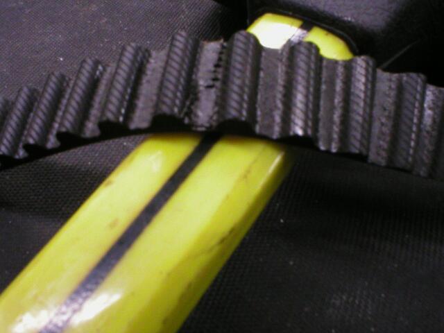

Well I know what a bad T-belt looks like.
If the teeth have any cracking at the base, replace the belt.
With the top cover removed you can shine a strong flashlight into the lower cover and look at the inside of the T-belt where it goes around the tensioner.
Attached Thumbnails 91: timing belt inspection-tbeltcrckib9.jpg
