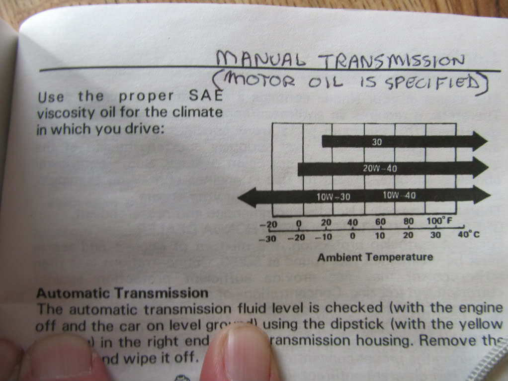

Replace the tranny fluid third: these cars spec engine oil in manual tranny
10w-40, 10w-30, or 30w. I just replaced my '92 w/ 10w-30. feels good.

Ya I noticed when I shift and rev it up it shifts better so I think it could be fluid. Slight leaks in places but nothing major. What kind of fluid is used for the clutch? Is it the same 10w-30 and is that 10w-30 tranny oil?

Hold on, you can use 10w-30 or 10w-40 for the transmission fluid. I would personally use the Honda manual transmission fluid.
The clutch hydraulic fluid (master and slave cylinders) is brake fluid. I believe it is DOT3. The cap on the master cylinder will say what DOT brake fluid to use.
Old Mar 16, 2013 | 10:07 PM
Honda manual-trans fluid will work a little bit better than engine oil. It is completely compatible.
DOT3 (or DOT4) brake fluid is used as clutch hydraulic fluid.
Old Mar 17, 2013 | 02:20 AM
UhOh's Avatar
Posts: 908
From: Washington State, USA
just to assist a newer owner ...
Hope this gives you confidence ...
Attached Thumbnails 93 accord lx shifting problem-img_1836.jpg   93 accord lx shifting problem-img_1839.jpg
