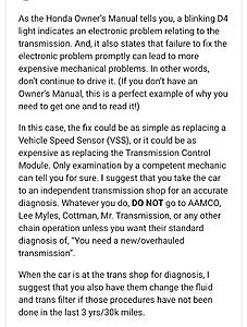

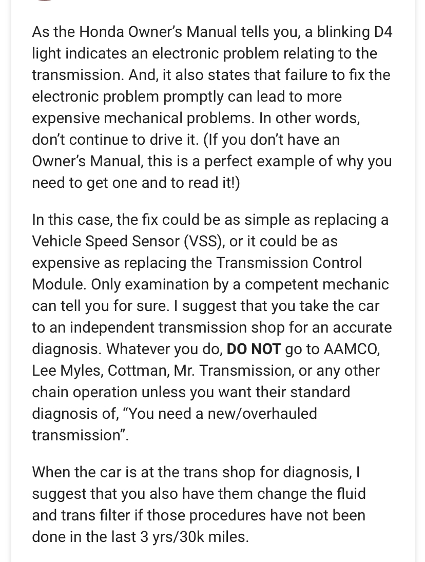

As stated above you need to figure the codes out. If you don't know how or understand it you might need to take it to a mechanic. Read the pic below. The D4 light only blinks when there is an issue and the amount of blinks will translate to a code so you can troubleshoot.
