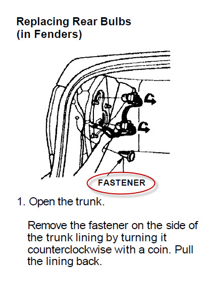

It is located in the trunk, as shown in the owner's manual. See images.
It should be taped with blue tape to the wire harness.
Attached Thumbnails 98 accord trailer wiring-trailer-connector.jpg   98 accord trailer wiring-liner.jpg
