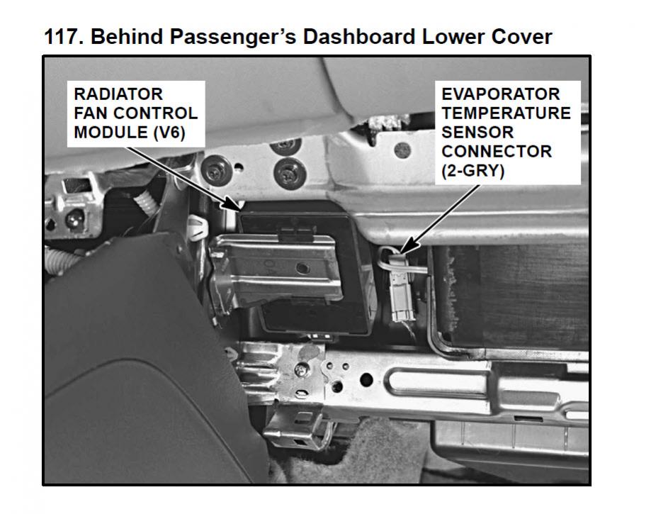

Since you guys are already on this thread and responding, would you guys mind if I chime in and ask a silly question?
Where's the radiator fan control module on a 2000 Ex V6 coupe? I have the Honda ESM cd, and I can follow the trouble shooting steps, but I can't seem to figure out where the control module is and the ESM doesn't locate it. My next place to look is behind the passenger glovebox.
Here's the steps I have done. Checked fuses (haven't checked the relays yet). Applied power to the fans with direct 12v and they both spin. With the AC off, the cooling fan will run but with the AC on, neither fan will run.

Here's the location of the radiator fan control module.
Test the relays too.
Attached Thumbnails 98 EX V6  Cooling Fan not working in drive-radiator-fan-control-module.jpg

Thanks Redbull! I had a feeling it was under there. What procedure do you suggest for relay testing?
