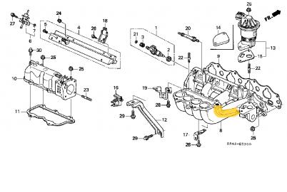

You can clean the EGR port that goes through the upper intake. You will have to remove the throttle body and the upper part of the intake (#10) to access the EGR port. I highlighted it in yellow. Use a pipe cleaner and brake cleaner to remove most of the carbon.
