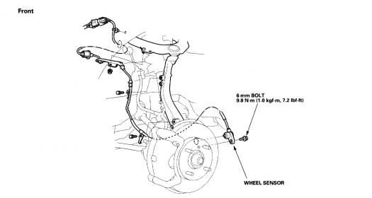

Need help with details on how to remove ABS sensor on the front wheel hub removed on a '99 Accord sedan? There bolt is easy to remove but the sensor
looks like it needs a special tool to remove the ring on the backside?

clear as mud?
Attached Thumbnails '99 Accord ABS/brake sensor removal-speed.jpg

Nice picture but doesn't answer my question.

sensor should just pull out, might have to twist it a bit. why are you replacing? swapping out hub/knuckles?

After that bolt is out, then the sensor is probably just stuck with corrosion. Soak with penetrating oil.
Have you got ABS error codes and checked whether it's actually a bad sensor?
