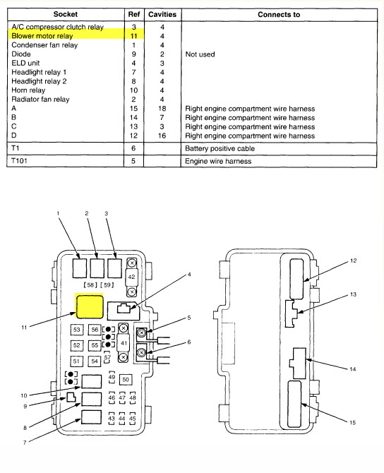

If the connector is okay, check for power going to the blower motor, if no power to motor then it may be the blower motor relay which is located in the under hood fuse/relay box. If power does go to motor and motor still doesn't run, then it may be the motor, such as worn out brushes, etc.
See attached image for relay location.
Attached Thumbnails 99 Accord Air Conditioner Controls-under-hood-fuse-box.jpg
