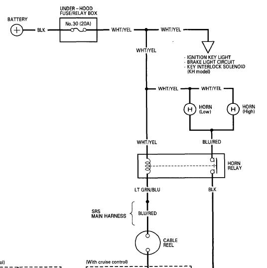

Ok, sounds (?) like the clock spring might not be the issue. PLEASE check the gound connections. Don't have a good manual for the 6th gens but know that Honda likes to use gounds to make things work.
The pic is for a 5th gen (94-97). Notice how when the horn relay closes, the ground is allowed to flow to the horn...WHT/YEL is hot at all times (from the under hood fuse panel) only when ground is applied to the horn (BLK coming into relay, then to horn thru BLU/RED) would the horn sound.
EDIT: of course if the clock spring/cable reel isn't grounding the "coil/magnet" side of the realy(LtGrn/Blu) then it wouldn't colse either.
