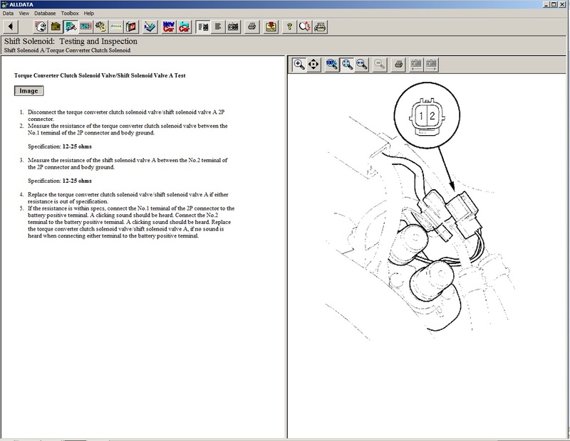

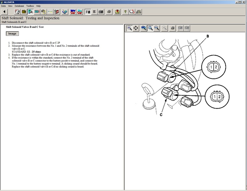

I have a 99 Honda Accord EX 2.3L BAXA Trans. Just did a complete trans rebuild myself and a friend, replaced all fibers and steels, gaskets, seals, and o-rings, (new) converter and filter. Had all foward and reverse gears before rebuild. (((((((Now all I have is 1st gear no reverse, 2nd, 3rd, or 4th!!!! No upshift..))))) Reason for rebuild was because of shifting problems... upon takeing it apart found worn fiber and burnt steels. Cleaned all parts in a clean enviorment and lubed all parts before reinstalling new parts. Added Honda fluid to (new) converter . Got 6qts in it and it shows its full...... NEED HELP PLZ

First fill fluid to proper capacity, low fluid will result in no operation.
Second check theese:
reply back when finished
Attached Thumbnails 99 Honda Accord EX Need Tranny HELP!!!!-asdf2hg.jpg   99 Honda Accord EX Need Tranny HELP!!!!-asdf1i.jpg
