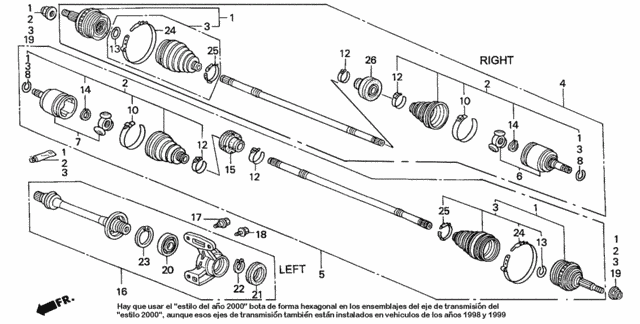

Here's the parts drawing. Looks like you CAN remove the outer CV joint.
I guess the retaining clip #13 might be accessible by flexing the CV joint way over. Then remove the axle from the spider of the outboard joint.
#3 is the boot-kit, about $28 here in USA. But the whole axle is about $400 from a dealer here...
Someone already warned you that if the boot is already torn, the joint might already be damaged by dirt getting in there. Like I said, I've replaced those boots, but they were only beginning to get surface cracks & nothing actually was split open. It's a very messy job.

i found an online manual that someone linked in this site where they show it can be removed with a sliding hammer.
Old May 18, 2018 | 06:08 AM
OK then I guess the clip #13 just snaps into an internal groove? That sounds similar to how the inboard end of the shaft unsnaps.
I recall threads where people didn't get the driveshaft fully snapped into the transmission, and after a few days it works its way out. So when you put it back together make sure it snaps fully into place (inboard and outboard).
