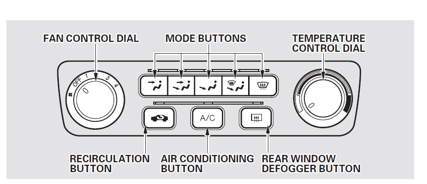

On the heater control panel, the mode buttons are used to select the vents the air flows from (see attached image).
These buttons on the control panel operate a mode control motor to move doors for the air flow. There may be an issue with either the wiring, motor, control linkage, or heater control panel.
