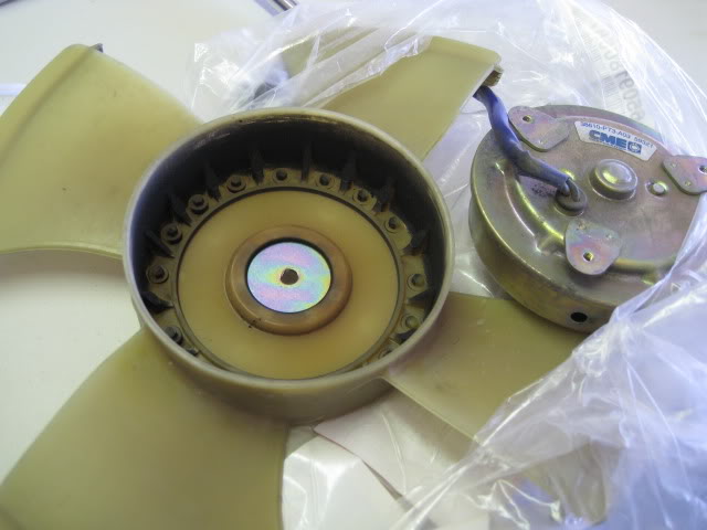

I have a 97 Accord 4 cyl. with 134,000 miles that recently started making a loud racket whenever the A/C was turned on. Traced the noise to the condenser fan on the driver's side. So I took apart the condenser fan and noticed there was fine black powder on the inside of the fan hub and the hub appeared to be slightly oblong in shape so I'll be replacing both the motor and the fan. I ordered parts from Majestic so they were cheaper than what my local dealer charges.

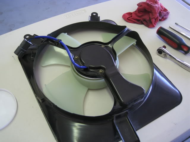

Finally got the fan and motor from Majestic. I replaced, both the motor and fan along with some of the hardware. Re-installed the condenser fan assembly and fired it up. Noise is all gone!
Here is the old fan hub filled with a fine black powder ... probably from the motor grinding away.

Re-assembled condenser fan assembly with new motor and fan.
