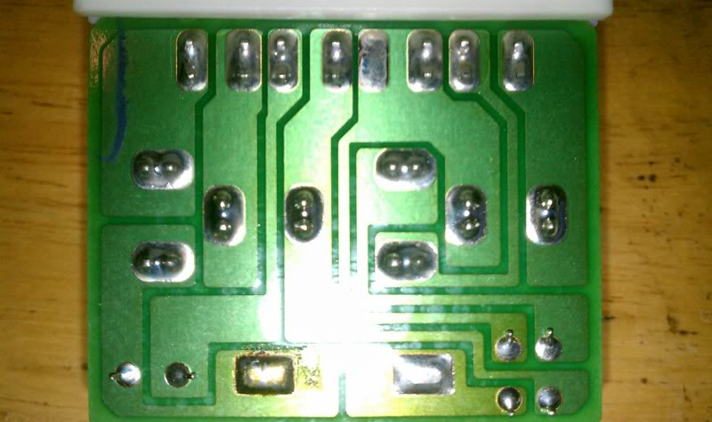

I was wondering if i could get some advice on the MFR. Maybe you guys see something i dont.

Search viIZ8k60awY on YouTube. This is a video on main relay repair. It will also show you what a bad solder joint looks like. I can't tell if you have a cracked solder joint from your pic.
