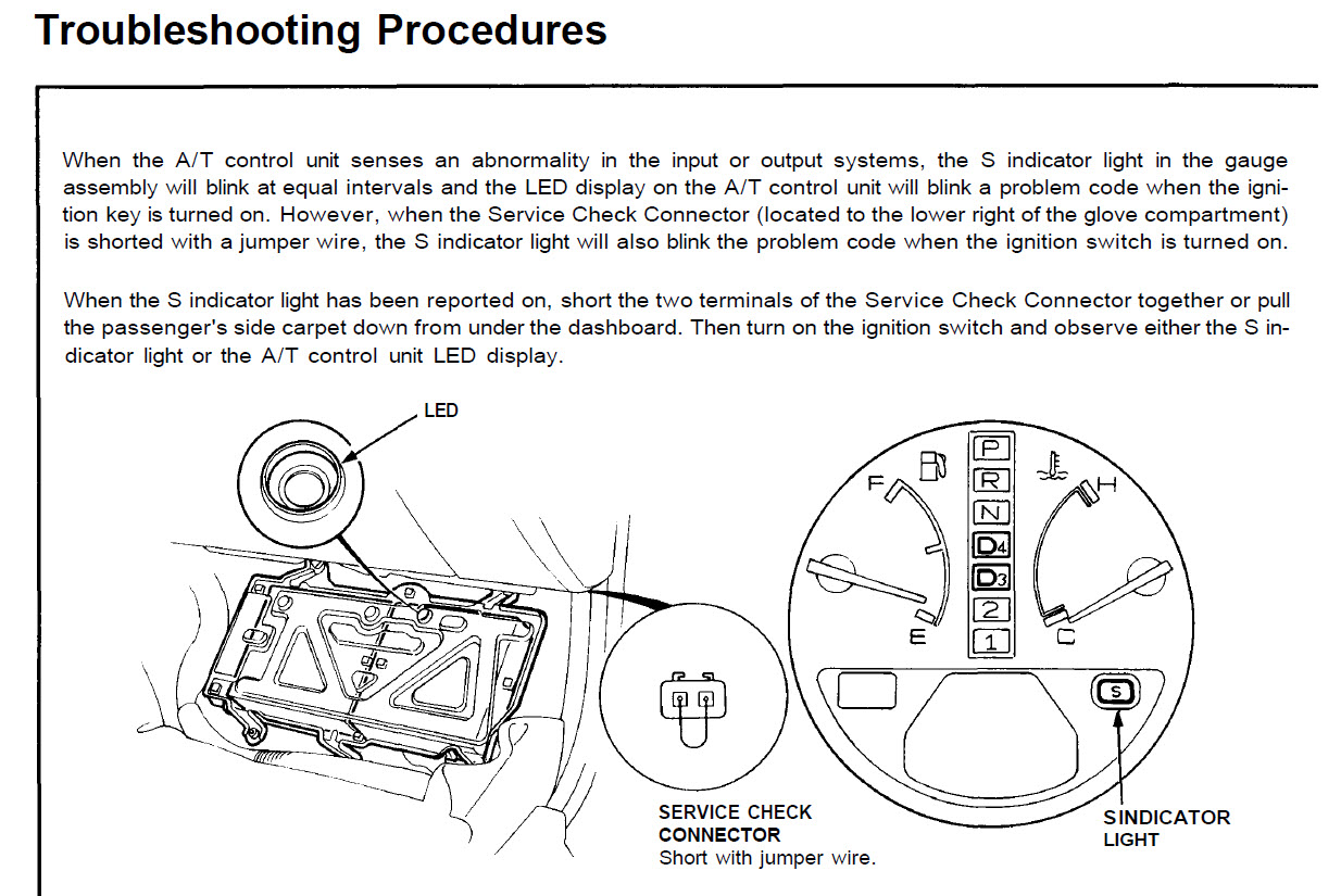

Your 1991 Accord's transmission control unit may have the LED display indicator as part of the module. Pull the passenger side carpet back to access it.
If the transmission control unit has the LED, turn on the ignition without jumping the service check connector to count the flashes of that LED.
Problem codes 1 through 9 are indicated by individual short blinks, Problem codes 10 through 1 5 are indicated by a series of long and short blinks. One long blink equals 10 short blinks. Add the long and short blinks together to determine the problem code.
