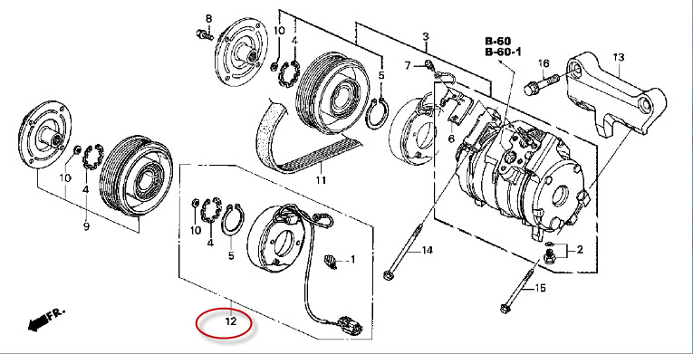

When you turn the A/C on, if the fans under the hood are running, and the inside blower motor is running; but, the compressor clutch is not turning, then you may have a faulty field coil. Your symptoms sounds like the field coil.
Here's some info. to give some idea about the field coil (stator set). The link is for an Acura TL; however, it is somewhat similar. The attached image should be the part for your car.

Attached Thumbnails Help! my A/c is all messed up-stator-set.jpg
