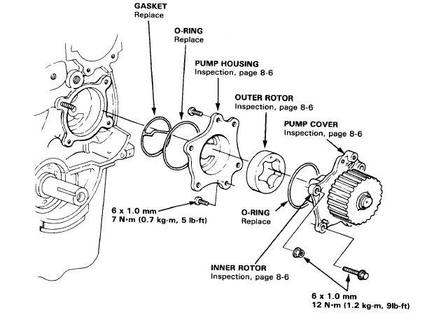

Based on your post, you have a completely different engine, but as a final thought I had a lot of success pressing in the crank seal using a short length of PVC pipe. 1 1/4 fit well under the crank bolt's washer and the gasket could be pressed in by a slightly larger 1 1/2 pipe. I used a very short section of 1 1/4 and had a 1 1/2 x 1 1/4 coupler that quickly changed size for me. When the pipes were joined, the total lenght for me was about 2 3/4" long. the new seal pressed in easily and it actually went slightly below the case.
For your seals, check out bernardiparts.com or majestic honda online parts. you can lookup for your model. looks like you have two, maybe even three orings for your oil pump. I think the numbers on the sheet were 4,10,11. sorry I couldn't post the link. Two normal round orings and the other has another piece of rubber crossing the center. All seem relatively inexpensive.

corrrection, 4, 9, 11 10 I think was a small oring for the oil tube. All the junk posted at the end was a paste of their part numbers. sorry.
004 15103-PC6-003GASKET, OIL PUMP BODY
009 91302-657-000O-RING (53.8X3.1)
011 91312-PC6-003 O-RING (57.8X2.4)

And that is what I get for going from memory...yes three and dang I did this in Sept of 2011....really loosing it. I was one of the last days I got to spend with the boy
For one of them you have to "open up" the oil pump....that one might be over kill, even though I did it on the 89 LXi because, I was there and it has over 200k, why not.
Attached Thumbnails Installing front crankshaft seal-3rd-gen-oil-pump-view.jpg
