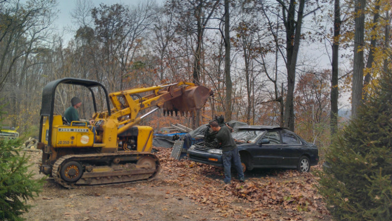

Hi again everyone. Wanted to come back and do a follow-up on my 94 Accord EX project as well as ask a question.
So after coping through superstorm Sandy and after lots of sweat, blood, and grease from head to toe, the motor is back in the car and 80% ready to turn the key over. This is my first complete engine swap ever, so I am a little nervous.
One problem my buddy and I are foreseeing is how we put the transmission back together. When we put the transmission back onto the car, we installed the torque converter first by bolting it to the motor side. We then put on the tranmissions, made sure it was seated to the block, and put all the bolts back in. My buddy was told that the torque converter should have been on the motor first and then installed to the block via the 8 bolts. We are worried it may not be correct due to doing it the opposite way. Can anyone us in on wether or not we're OK or wether we have to completely tear off the tranny and do it the opposite way?
Thanks!
Here is a a progress pic of us lowering the motor in:

BTW - love your engine hoist

Also, another question you may be able to answer. The new motor I have now in the car that I bought has a plug/sensor on the timing cover. On my cars wiring harness I do not have a plug for it. Any idea what that would be on this motor? I've read it may be where the cam sensor is, but on my car the cam sensor is in the distributor. Also, on my fuel injector harness I have an extra connector, where does this go? I am assuming to the purge solenoid valve?
Thanks for the love of my hoist. I can't take credit, it's my buddies dozer but boy did it come in handy We used to yank the old motor and insert the new motor Thanks for the love and all your great information. Greatly appreciated.
