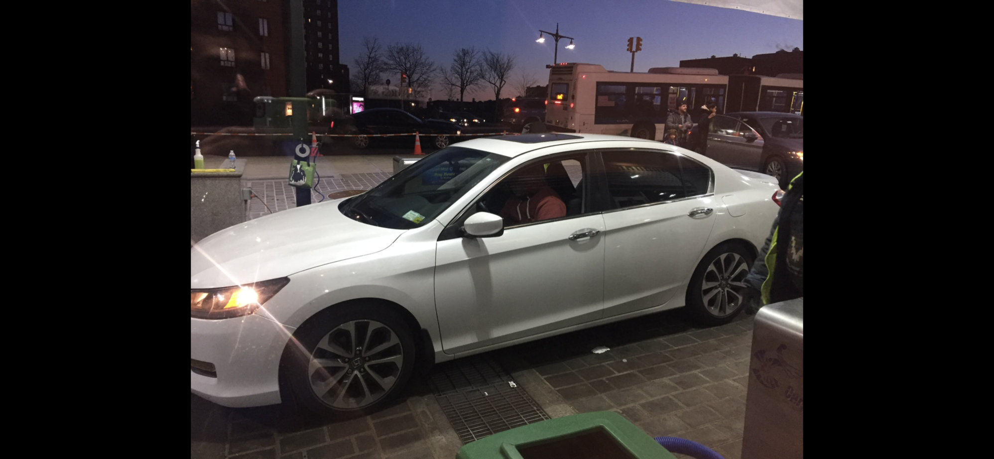

Default 2013 Honda Accord water leaking in front passenger site floor
Greetings everyone! I'm a brandnew member here. I have came across over this forum while browsing for my 2013 Honda Accord front passenger site floor water leaking while take the car inside the car wash. Water start gushing in only when i take it to the car wash only not when it rains or snows. I took it to my nearest HONDA service center here in Bronx , NY area and they told me that I have a sunroof which is not factory installed and they can't fix this issue and I have to take this to an after marketplace or something. I just didn't get it if the saying that sunroof is causing the issue. I also wasn't aware of this sunroof installation as i bought it from a Massachusetts Audi dealer as used car with 10K mileage back in 2015. There's never no water leak or drip from the sunroof at all ever. I don't know why Honda service center can't fix this issue even if the sunroof is original or not and they charged me $150 as diagnostic fees. I'd much appreciate if someone with some knowledge /experience advise me here. My car has only 63K MIleage currently and I need to drive this for another few more years without spending a very hefty amount just to fix this issue or selling this car out.
