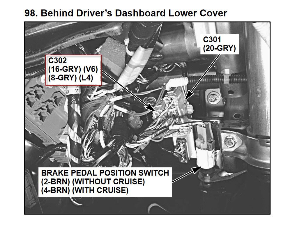

The green/red wire (green color wire with red stripe running through it) looks to be the positive wire for the brake fluid level switch. It runs through the firewall to Connector C302, terminal no. 3.
You can splice a new wire in between the green/red wire coming from Connector C302 to the green/red wire at the brake fluid level switch.
You may want to use a multi-meter to test for continuity on the green/red wire between Connector C302 terminal no. 3 to where it breaks off to make sure that is the correct wire.
