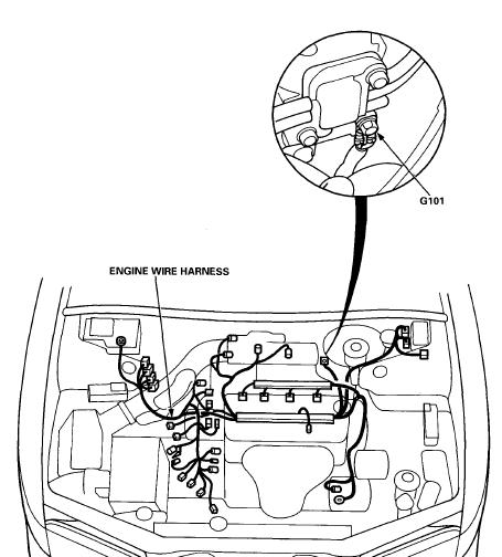

Old Jul 25, 2011 | 06:32 PM
Double check the main ground (G101). Should be on the drivers/left end of the tb.
Attached Thumbnails no start/spark 1994 accord ex v-tec-5th-gen-g101-location.jpg

Thanks for the help, you both were right. body ground was off, and I had to swap ignitor as well.
