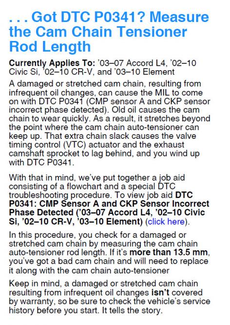

Is it still having the P0341 trouble code and the symptoms of idling really bad, etc.?
A damaged or stretched chain will set the P0341 trouble code. Infrequent oil changes, etc. can cause the chain to wear quickly.
