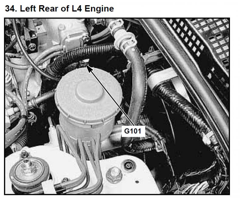

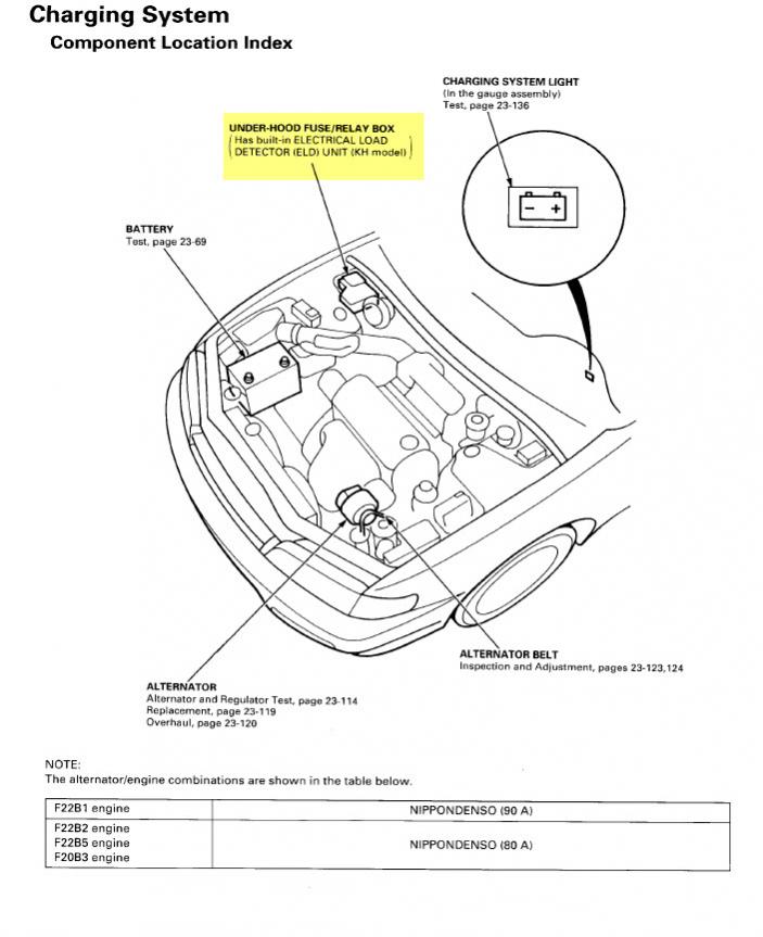

The ELD is built into the under-hood fuse/relay box, see attached pic.
For P1297, check the ECU ground at G101, see attached pic.

Thanks for your post. this gives me a lot of hope actually. Now the FSM had nothing on the ELD. It showed the fuse box and did not label (even though its built in) so I was at a loss. But I did see the g101 connection in the diagrams. that one I had to take off and put back on during my intake manifold swap. What I did was use a wire brush on the part where I connected the ground on the manifold. I dont see why it wouldnt ground on the f23 manifold. Should I try just attaching it to the chasis or does it have to be on the manifold? a ground is a ground right?

I just checked some stuff on my car. I check g101. it was secure but also, the car does not run without it. So if it wasnt secure my car would randomly shut off. I did the test to see if its the ELD. According to the instructions because theres no CEL when I turn on the headlights then I gotta check for loose connections.

I don't see why either. I just hooked G101 to the F23's intake manifold too with no problems. Grounds aren't all equal. Sensors are low voltage, take very little current, and good grounding is essential to having them work correctly. Intermittent dimming dashboard lights could definitely be caused by a bad ground. Break out a DVM and check continuity between the negative battery post and the engine ground lugs. There shouldn't be more than a couple ohms resistance.
