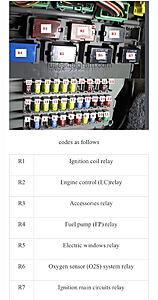

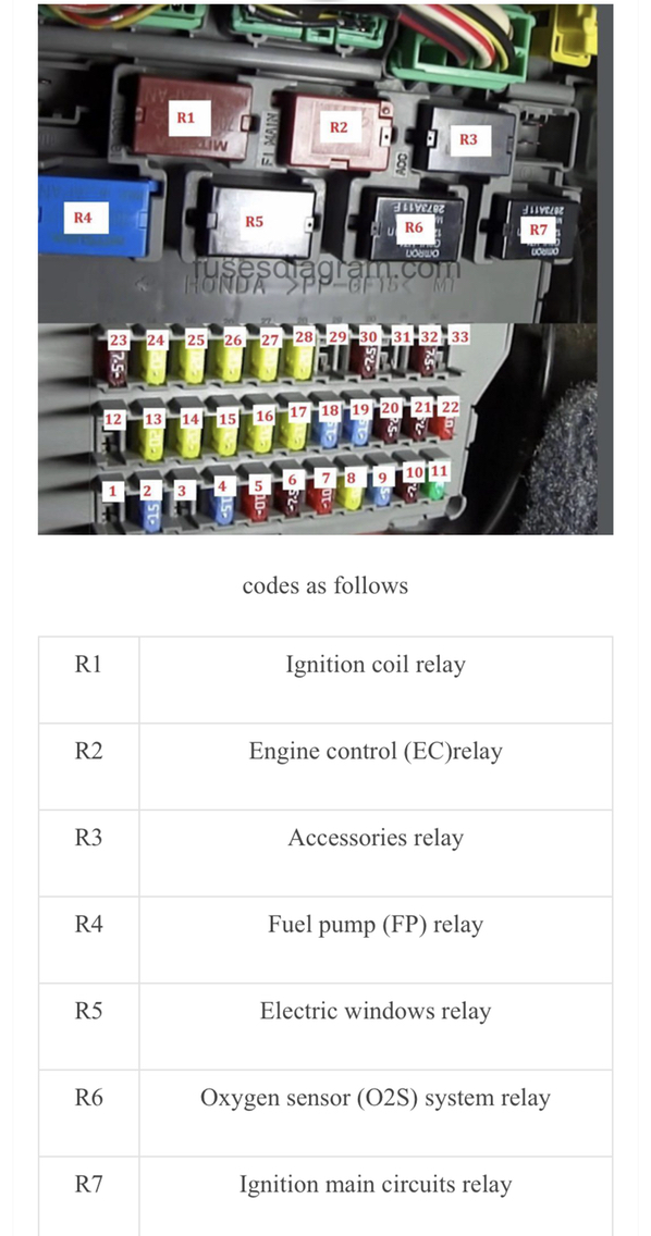

You have an ignition relay relay under the dash. Should be around 6 or 7 relays just above the fuse box.
I forget which one it is but just swap 1 and 2 and try. If it works then it's 1 that has the issue. If it's doing the same then switch 6 and 7. If that works then 7 was your issue. It can also be the ignition switch.
When it happened to me I changed my switch and relays since I knew both have issues after a while.

Found the diagram
