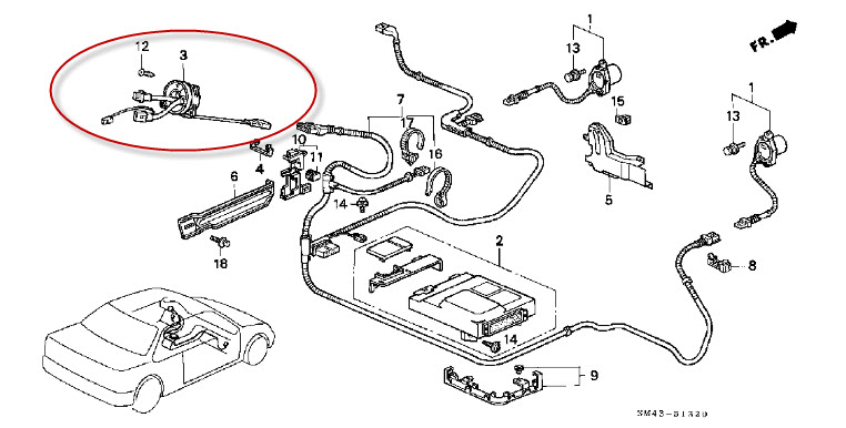

Probably a damaged cable reel. The cable reel can easily break if it is overextended. The cable reel and steering wheel needs to be centered when it's put back together; otherwise the cable reel will get to the end of it's travel in one direction before the steering wheel reaches it's max travel. This will break the cable reel and you won't feel a thing when it breaks.
A damaged cable reel can set the SRS light and DTC and have the horn and cruise control not work.
They are kind of expensive, so maybe search a salvage yard.
Attached Thumbnails Post Ignition Lock Cylinder Job:  No Cruise, Horn, SRS-cable-reel.jpg

That's gotta be it. Thanks!
