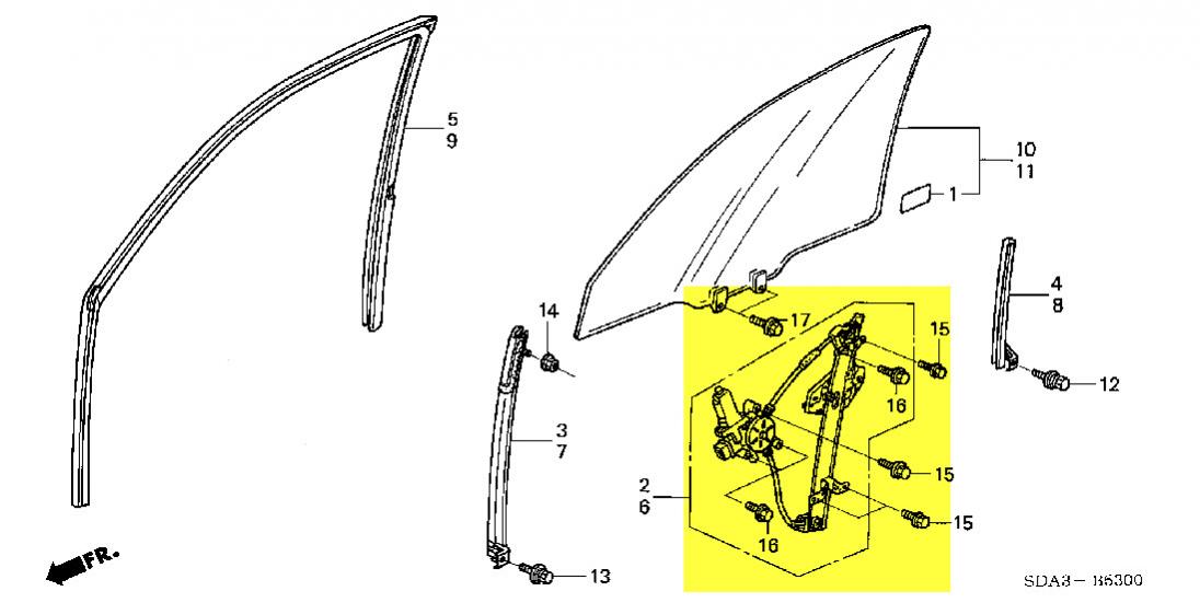

Roll up my window last night as I get home from work and there is a loud bang. Having many POS's in the past I know this is not good. This morning the window is halfway down. Take off the door panel and see the top cable has broke. My question is can you just replace the cable or do you have to do the whole regulator assembly? On a scale of 1 to 10 DYI wise where is this project a 1 being replacing the cabin airfilter?
FYI car 2004 Accord EX V6 no Navi.
Old Jun 14, 2012 | 07:18 PM
Posts: 7,101
If the cable you are referring to that is broken is part of the power window regulator assembly, then you have to replace the assembly. See attached pic. of regulator assembly. If you are talking about some other cable, then a picture would help us determine what else you are referring to.
Removing the door panel is already part of the job. With the panel off, I would estimate the job a 4 or 5 on the scale. If you didn't know how to take off the panel, then a 6 or 7.
This link shows Dorman's instructions on replacing the front regulator.
www.dormanproducts.com/DigitalAssets/Document/741-306_IS.pdf
In step 8, you only have to remove 4 of those bolts, and loosen 3 of them. The three bolts that are loosened are used to hang the regulator and motor in place during removal and installation. I edited their picture to show which ones (see attached pic.).
