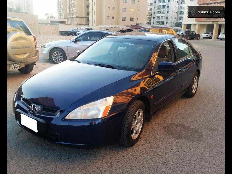

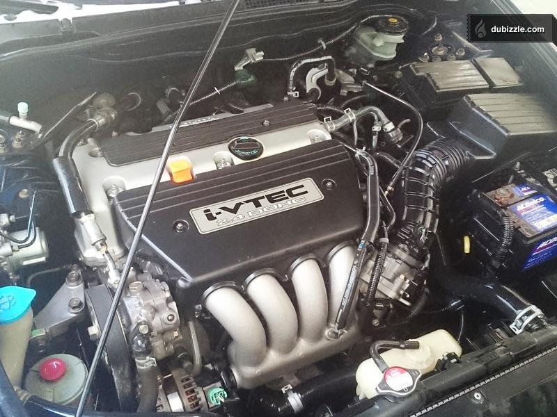

I Actually don't know
it is a 4 door, 2.4 i-Vtec 4 cylinders
manufactured in 2004
here is some images..
