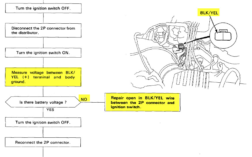

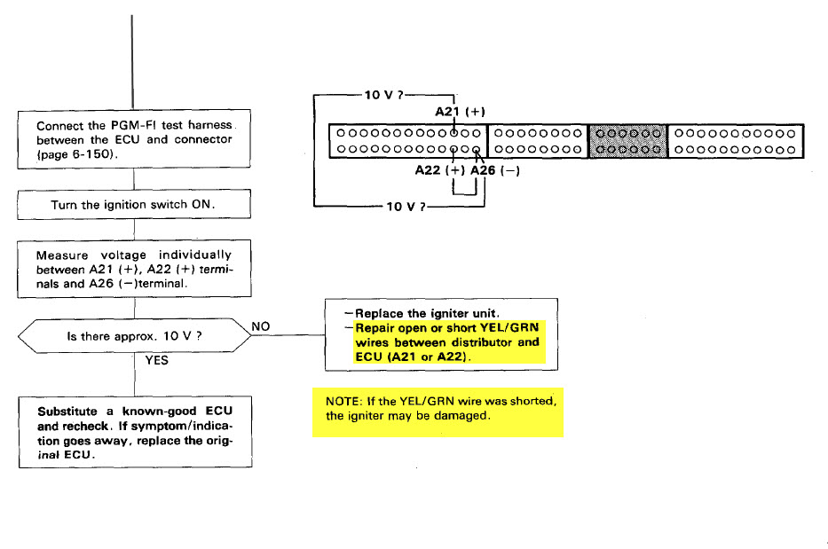

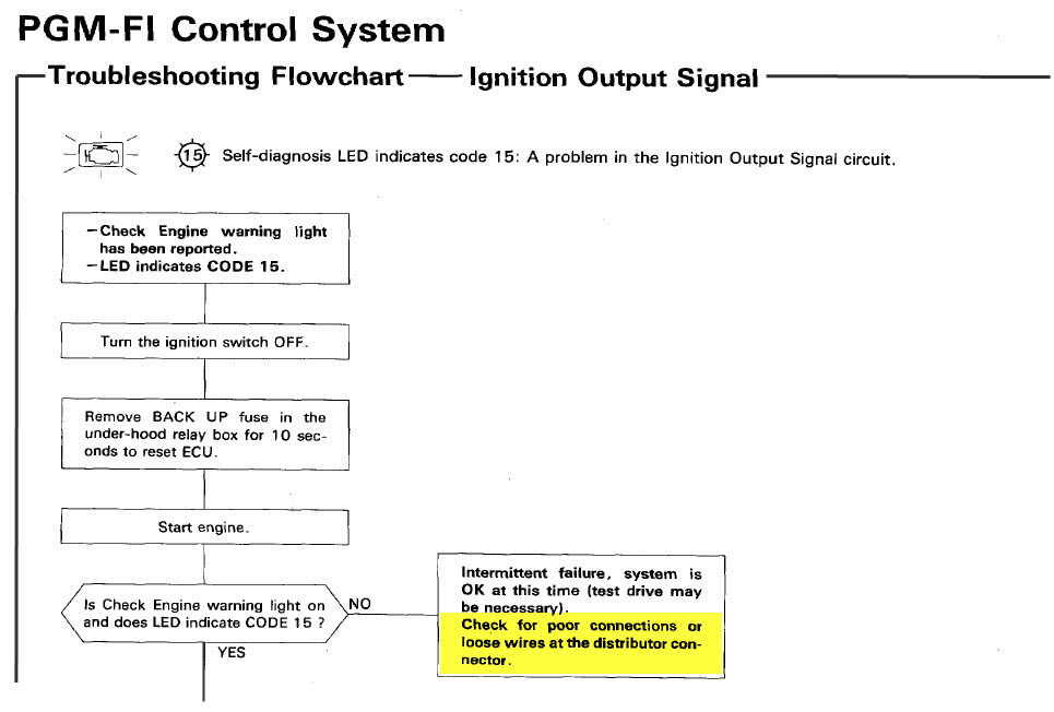

Here is the Code 15 troubleshooting, with a few things I highlighted regarding the wiring.
Attached Thumbnails relay jacked... WHY??? gotta look!-code-15-ignition-troubleshoot-part-1.jpg   relay jacked... WHY??? gotta look!-code-15-ignition-troubleshoot-part-2.jpg   relay jacked... WHY??? gotta look!-code-15-ignition-troubleshoot-part-3.jpg
