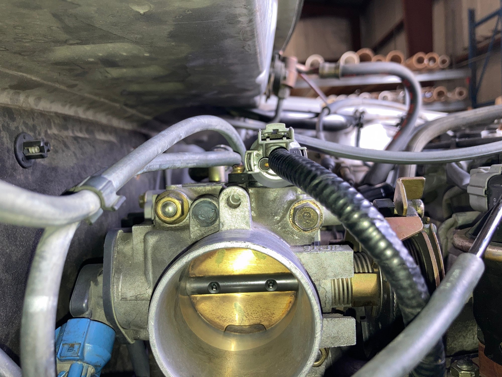

SO, this is how i found the idle screw. It was screwed all the way in tight. Loosening only increases the idle. How am I supposed to set the base idle when 900 is screwed all the way in? What else can be done to lower the idle? (Apologies, I have no idea how to make these pictures smaller.)

The EVAP purge valve is dead center behind the valve cover close to the PCV hose. The rest of the EVAP system is under the car. You just disconnect the electrical connector to disable. According to the shop manual, that is all you need to set the base idle. Investing in the 98-02 shop manual I referenced earlier will help you with these items vs information on the web.
Your issue is strange, because your fuel trims are normal, but your car is behaving like it has a vacuum leak.

It is still idling at 1k unless the fan or a/c loads are on.
We've sprayed carbs cleaner and starting fluid all over the engine without it sputtering or revving. With the idle screw all the way in, it is very quiet, but as soon as it is turned you can hear the air going through it.
After driving for a few days now with the aftermarket relay in, the idle hunt while cruising has almost disappeared. When reaching work or home it will hunt a time or 3 and return to idle.
While the intermittent symptom and the code seem to be right, I have to get the idle down some kind of way.
