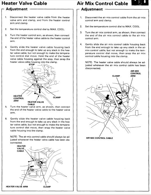

There is a shop manual for the 94 you can download. The process is the same. There are two calbes in the system. One from the **** on the dash, it runs down the the blend door lever - there is a cover with on push pin you might have to remove to see it. The other end of the lever connects the other cable that runs to the heater control valve.
Attached Thumbnails Tip:Fixed My A/C,It Wasn't Broken Though.-5th-gen-blend-door.jpg

Thanks, poorman212. I took a look at it again and here's the issue I'm having. The setup on my '97 looks slightly different than whats in the image. I don't see a way to adjust the cable. There are two "collars" on the cable sleeve and they're spaced apart by the width of the clamp. The collar at the end of the cable sleeve is about 1/4 inch wide. The other collar is about 3/4 inch wide. Those can't be moved and they're too big to fit in the clamp. I checked my replacement cable and it's the same as far as those collars go. The water valve cable doesn't have those collars and can be adjusted.
When I push on the blend door arm in the direction it would move when you select COLD, there's a little bit of additional movement. That's why I bought the cable. It seemed like it was too long and maybe it stretched over the years.
Am I missing something?

Early production year 1995 Accords air/mix control cables can be adjusted. Do not try to adjust late production year 1995, 1996, and 1997 Accords, as they came with a non-adjustable air/mix control cable.
Refer to my post # 9 in this thread:
https://www.hondaaccordforum.com/for...ter-fix-48610/

Thanks, redbull-1. I thought I was missing something in the shop manual. I hate it when the documentation is wrong. I expected more from a Japanese company as the Japanese are very particular about having the correct documentation.
I wasn't aware and hadn't considered that the valve could strip. I just assumed (yeah, I know what that means) that if the lever were moving that the valve would close. I have some more homework to do. This all makes sense now and some of it should have been obvious to me.
