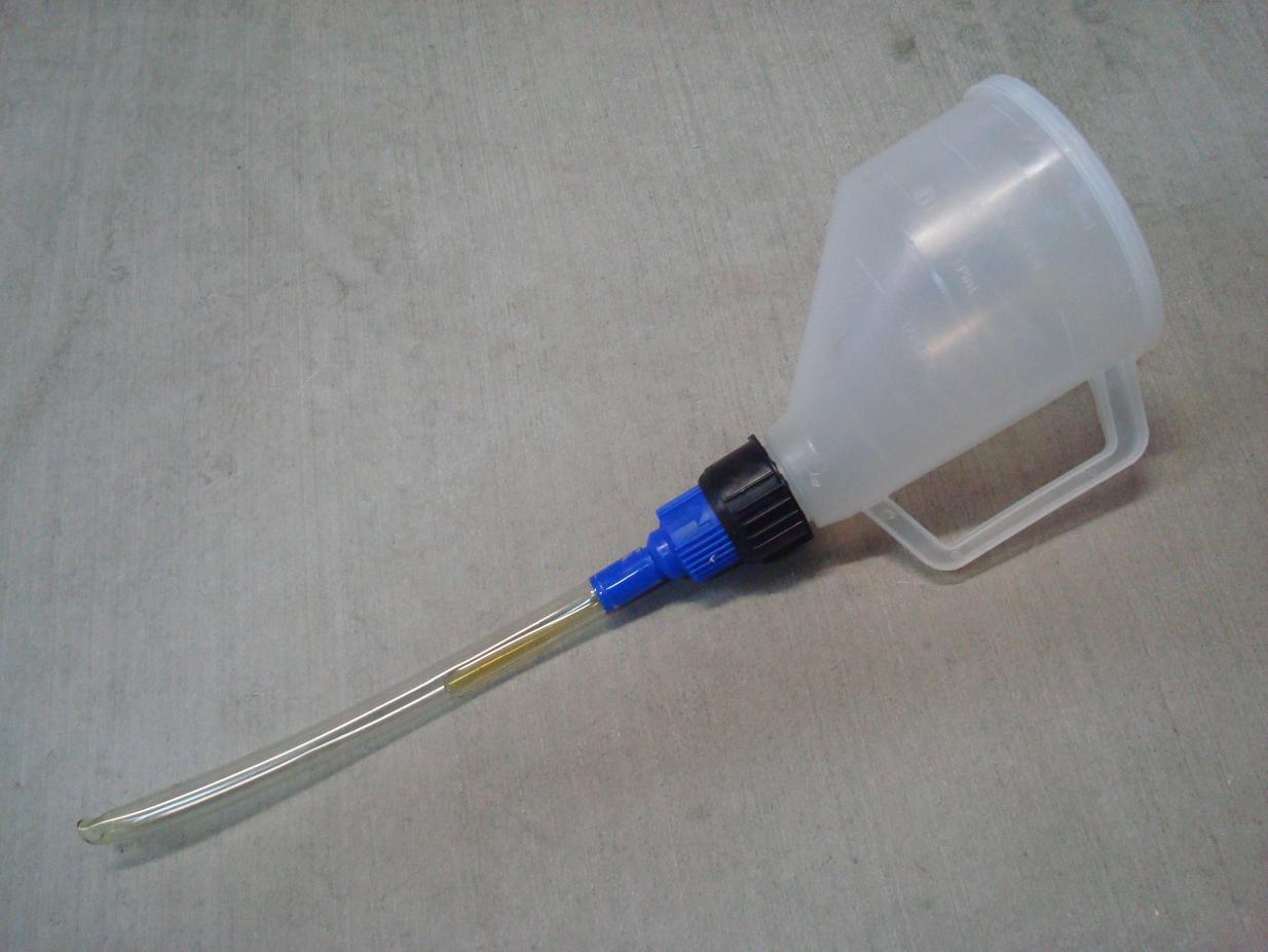

I got with the original ATF-DW1 from Honda, about 20 bucks a quarter.
The dipstick happens to be not only deep but small room to work, pipes and hoses running there.
The fluid seller told me that I will need some sort of device to put the ATF in the transmission, some sort of applicator thing ... well. I though it was a bit easy, using something like that ....
I saw in vid on YT the people heat up the ATF fluid to get it running easily during refill ... I need to work out a way to do that.
What do you think ?
