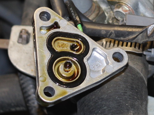

Mine is leaking. I took a few pictures of it to ask a friend of mine what it is and should I replace it or new gasket or rtv or what?
He said he never got the email. I ran across this thread while trying to figure a different issue. Of course I have reinstalled that thing without fixing anything.
Should I change the part or just get a gasket?
Any help would be appreciated.
David
Attached Thumbnails  vtec solenoid gasket-img_3388-2.jpg    vtec solenoid gasket-img_3393-2.jpg
Old Mar 30, 2009 | 07:46 AM
RTV has a risk of getting gunk in the tiny passageways of that valve. I'd get a new gasket.
