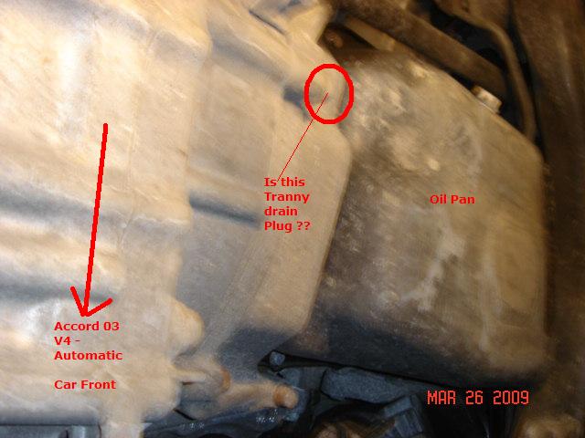

Hi All,
Where is the tranny oil drain plug for accord 2003 v4 Automatic????
I attached 2 pictures for drain bolt location (that's my guess). So please I need someone to confirm , is this the right bolt? Is this the right location?
In some forums I read it's next to the passenger wheel. But when I looked in my car, nothing was there.. The only one I can think it's , next to the oil pan from the driver side, as shown in attached pictures. Please advise!
Thanks in advance
Attached Thumbnails Where is the tranny oil drain plug for accord 2003 v4??-dsc04141.jpg   Where is the tranny oil drain plug for accord 2003 v4??-dsc04136.jpg

From what I can see you're correct. The tranny drain hold doesn't need a socket, just simply stick a 3/8" ratchet w/ or w/o an extension.
Refill using the dipstick hole.

#7 is the drain plug, which appears to be where you have it pictured.

Thanks a lot. I will give it a shot this weekend. So when I drain it..about 3 quarts will be drained and I will need to add 3 new quarts, right?

About 3 quarts, maybe 3.5? There is a dipstick for the tranny and it should be at the top mark on a level surface with the engine off.

If you haven't done the change yet, the drain plug is right in the center, up front, with a 3/8" square for a ratchet or breaker bar. (Looks like the green circle may be it) Easy to find. Refill is exactly 3 qts. (be sure to check it with the dipstick)
Change 3 qts, drive it for an hour, day, week, then repeat the process. You can only get about 1/2 of the fluid at each change.

I did change the tranny oil and the plug as finch13 said. It's # 7 , which is as shown in my attached question pictures.
