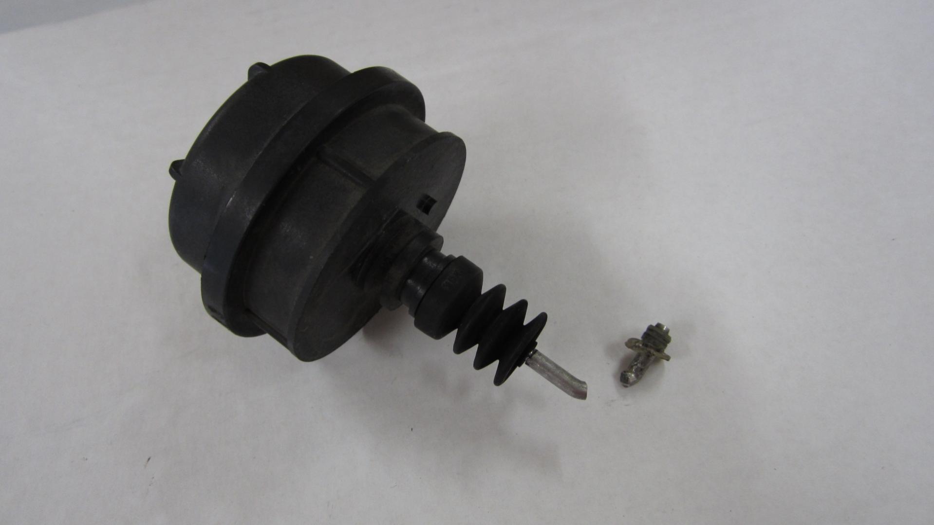

Last Sunday I managed to change out the vacuum actuator on the rear engine mount. I had the problem with loud engine vibration resonating through the cabin of the car during low idle. After replacing the front mount (which had torn rubber) a few weeks ago, I thought the rear had torn as well. Turns out of all things it was the metal linkage on the actuator that had broken, rendering the the multi-stage damping of the mount inoperable.
It was an extremely tight fit from the rear opening, and took me a couple of hours with long pliers, screwdrivers and various rods to push with ... but I managed to change out the actuator without removing the mount. Here's a pic of what I removed.
Fyi the replacement actuator I found off a cheap used mount -- I do not know where you could find these new. There is a NOK logo on the plastic casing, but I have not found this piece or the mount sold anywhere under the NOK brand name.
