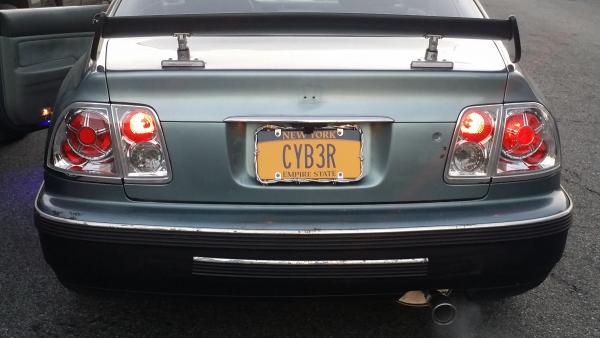

New Tail Lights

Nice lights....is that a 96 or 97 Accord?
