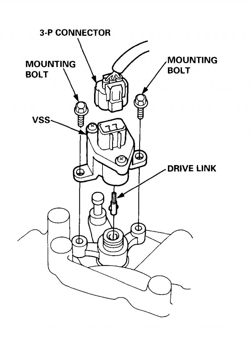

Check that you didn't accidentally lose the drive link for the VSS. See Pic attachment.
If the drive link is still there, then It could be a wiring problem. I would test the electrical connector that plugs into the speed sensor with a volt meter.
The VSS connector has three wires. One wire is ground (probably black). The other two wires should be tested for voltage. One will have 12V and the other should have 5V when the key is turned to the II position.
When testing the touch one lead of the volt meter to one pin on the VSS connector and the other lead of the volt meter to a known ground (engine block). Use the voltage setting to test for voltage, obviously. Use the continuity or the resistance setting for testing the ground wire. The ground circuit should read closed or zero resistance.

this all makes sense and for a while i thought the drive link may not have been in but it is and would not explain why it randomly comes on and goes to the high speed i will test it because anything at this point would be awesome i hat guessing speed too slow or too fast i dunno but those photo radar cameras iam sure would tell me
