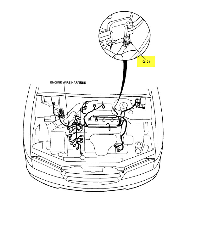

Originally Posted by CWPWBONE
I did the paperclip in the 2 hole blue bracket on the passenger side and got no blinks but the check engine light stays on?
Check the ground for the ECU to see that the wire and connection looks okay. There may be a problem with the ECU or wiring.
